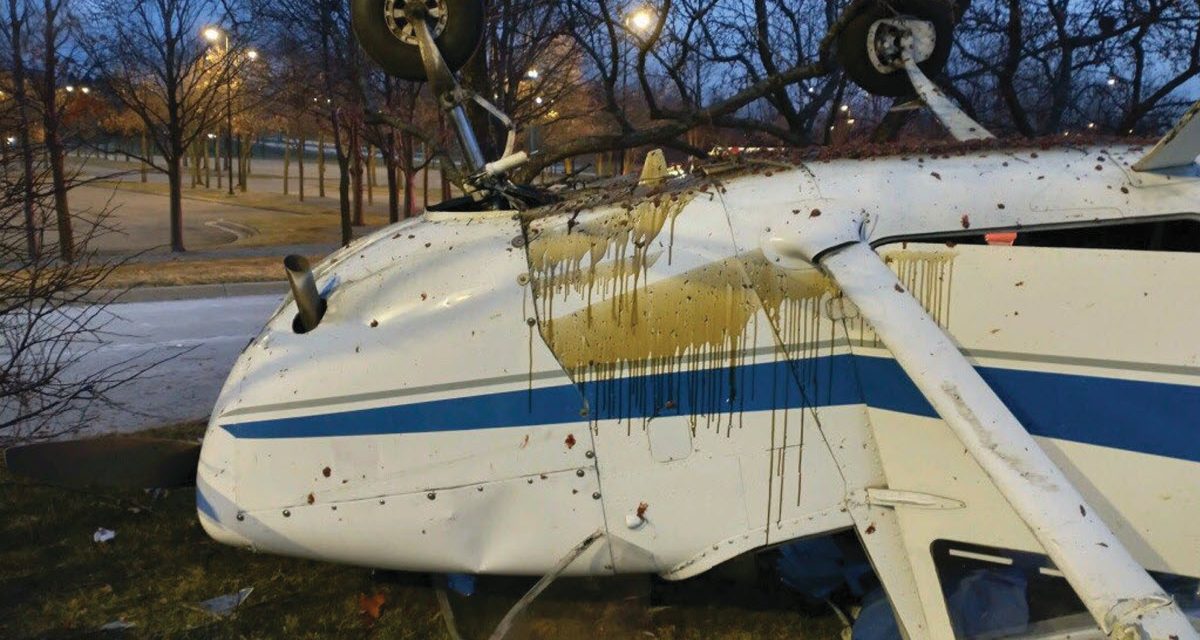

Take a look at the photograph above. Here’s a 172 that’s upside down and met its fate on a boulevard of dreams lined with trees. This very recent accident is what spurred my memory of the Navajo stuck in Colorado. As I read the accident report, which luckily did not involve any fatalities, I had to laugh at the fact that the issues that caused the Navajo incident so long ago are still valid problems that manifest themselves even today.
Accident Narrative
Location: Auburn Hills, Michigan Accident Number: CEN23LA067
Date & Time: December 21, 2022, 14:47 Local
Registration: N8768U
Aircraft: Cessna 172F Aircraft
Damage: Substantial
