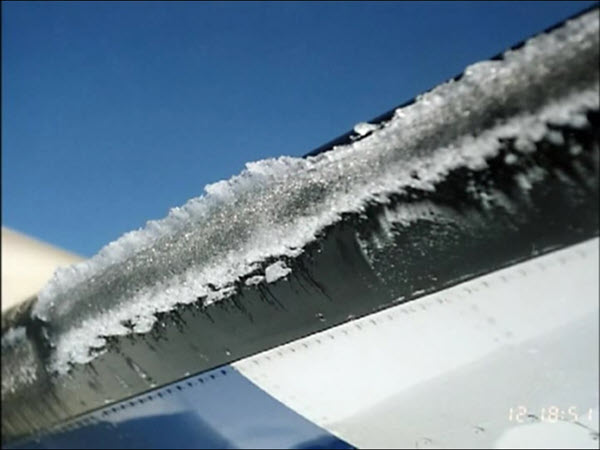

It was quickly decided that in the interest of safety, the test flight would not be flown in actual IFR, icing conditions. Rather, the engineers at NASA attached a strip of material to the leading edge of the left horizontal stabilizer that would simulate the shape of a substantial amount of mixed ice. In addition, the Otter was rigged with cameras and data collection instruments to record the event.

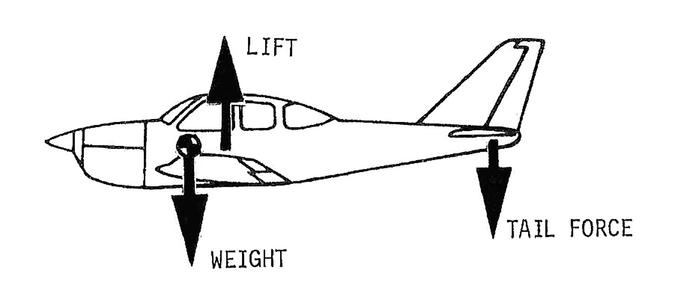

To understand the tailplane stall requires a brief review of aerodynamics. The center of lift, which is the point on top of the wing where maximum lift is produced, is normally associated with the thickest part of the wing. The center of gravity is always forward of the center of lift. Because of this arrangement, there exists a lever arm between the two that is constantly trying to pitch the nose downward in flight. The pivot point (or point of rotation) is the airplane’s center of gravity. This nose down pitching moment is counteracted in flight by the horizontal stabilizer which makes lift downward resulting in an uneasy state of equilibrium.
The opposing forces on an airplane exerted by the wing and stabilizer in level flight are similar to a playground seesaw that has two kids of equal weight on each end. As long as both kids stay put, equilibrium exists. A tailplane stall is the equivalent of one kid suddenly jumping off his end of the seesaw, causing the other end to crash to the ground.
This illustration shows the relationship between the center of lift and the center of gravity.

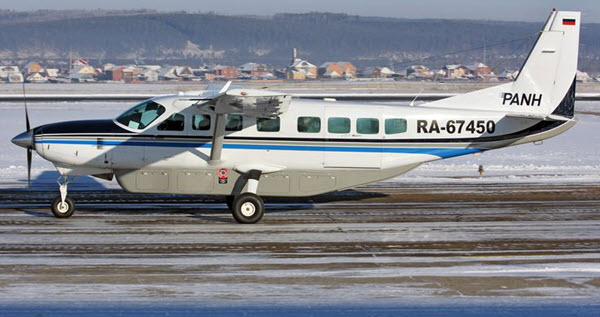

Now rewind to February 27, 1990. At 6 p.m., I climbed into the right seat of the 737 simulator. At about the same time, a Federal Express Cessna 208A Caravan, N820FE, departed Aspen, Colorado, with a load of freight and mail bound for Denver’s Stapleton Airport.
An example of mixed ice on the leading edge of a wing. Ice accumulation on the leading edge of the airplane’s stabilizer is one of the catalysts for a tailplane stall.
Cessna Caravan showing relationship between flaps and stabilizer.
The Caravan’s pilot was a Denver police officer who flew freight for a FedEx part time. His name was Bill Head. Bill was a very courageous guy! Flying single pilot, in a single engine airplane, at night, in IFR, icing conditions over the Rocky Mountains was about as gutsy as you can get. In fact, it is just slightly less dangerous than getting shot at while flying combat in the military!

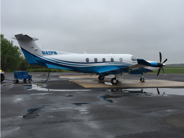

More recently, when I checked out in the Pilatus PC-12NG, I noticed in the POH that tailplane stalls are addressed, even though the Pilatus is a low wing airplane with a very high T-tail. The procedure for the PC-12 to avoid a tailplane stall when landing with ice adhering to the airframe is to use no more than 15 degrees of flaps, where 40 degrees was the normal setting. In addition, if the deicer boots are inoperative, a landing must be made with zero flaps. Even with its low wings and high T-tail, the Pilatus PC-12 can fall victim to a tailplane stall.
How Full Flaps Can Cause a Tailplane Stall on Some Low Wing Airplanes
On most airplanes, the use of full flaps for landing causes a reduced angle of attack for the wing which increases the angle of attack of the stabilizer. On certain airplanes, such as the Pilatus, if the stabilizer has a significant amount of ice on the leading edge, full flaps can cause it to stall, even though the airflow from the flaps does not strike the stabilizer from above.
This, along with my incident flying the Cherokee Six, indicates that full flaps can be the catalyst for a tailplane stall regardless of wing configuration. With this in mind, a landing with any amount of ice on the wings and stabilizer should be made at a higher than normal approach speed and (considering runway length) the lowest degree of flaps, with zero being optimum.
