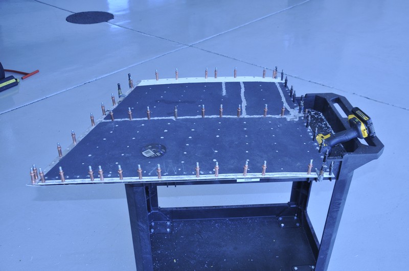

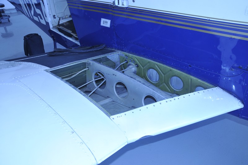

Picture 1 shows the wing walk before it was unriveted and removed. As you can see, it looks just great. Visually you can’t tell if there’s a problem or not; you have to feel it.

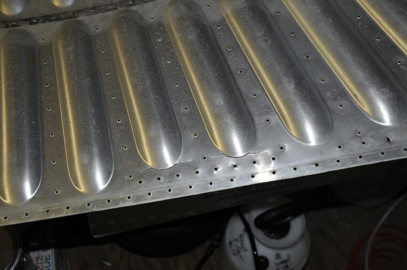

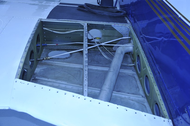

My shop mechanics as seen in Pictures 2 and 3, then drilled out the rivets and removed the assembly, which consists of two layers of plates. The top layer is a sheet of flat aluminum that gets coated with that black tarry wing walk coating to keep you from sliding off the wing and suing Piper.
Underneath is a second layer as seen in Picture 4. Look closely and you can see 40 years of stress cracks from people walking on the wing. Both pieces are getting replaced. It should be noted that there were many cracks, not just the couple shown in the photo.
I made another observation, too, while looking in the wing (Picture 2 and 3). The aluminum is bright and shiny, just like it came off the manufacturing line in 1977. No corrosion, dirt or wear anywhere. It was very comforting to know that this airplane has absolutely no corrosion. Just for the record, I took a permanent black magic marker and wrote “Scott Was Here, October 2018,” on the inside of the wing.

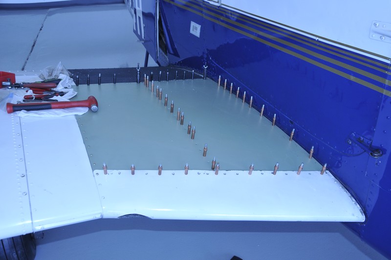

Picture 5 shows the old wing walk top plate placed on top of the new top plate. The holes needed to be drilled to fit what Piper built by hand in 1977.

What you don’t see is a couple of days of two mechanics re-riveting all of this back into place, which to me seemed a herculean effort. One mechanic was under the wing with a bucking bar and his hand snaked up through the wing via an inspection panel and the other mechanic on top with a rivet gun pounding them into place.

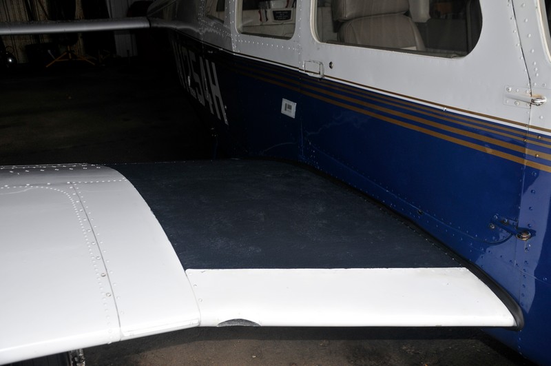

I didn’t put a final picture showing the project complete because it would look identical to Picture 1. However, the project is complete, and the wing walk looks just like it did on the day that the factory made it back in 1977. My shop did an excellent job and my Arrow is ready for another four decades of flying.
