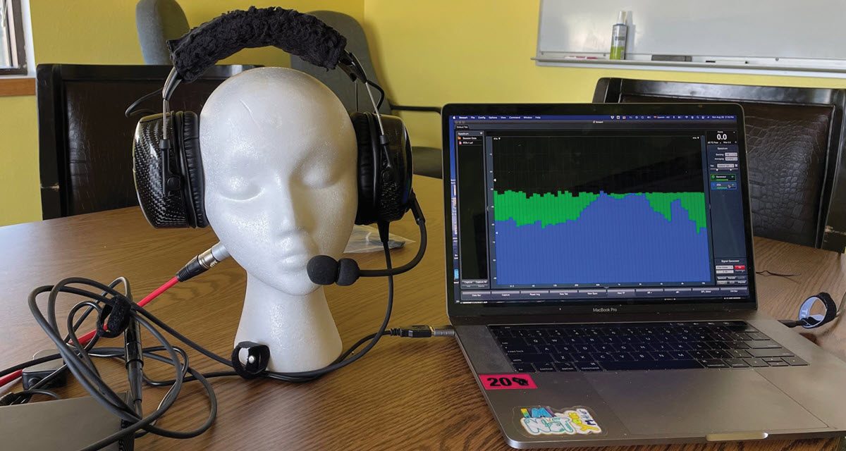

A few years back (in the July 2022 issue of Cessna Owner magazine), we reviewed three headset brands and shared how we did those tests. However, we never shared what we learned in the process. We started by measuring base line sounds in my Cherokee 180 during cruise flight. We then recreated the sound in a lab environment electronically to minimize outside factors (see the green portion of the graph). The blue portion in the graph is the cancelation of the sound, ranging from very low frequencies to very high. As you can see in the picture, sound reduction to the ear is not perfect in every frequency range. Perfect would be indicated by blue completely covering all the green.
We learned from this test not only how loud sounds were effectively cancelled or reduced, but which frequencies were cancelled best by which headsets. No headset was perfect in all ranges.
