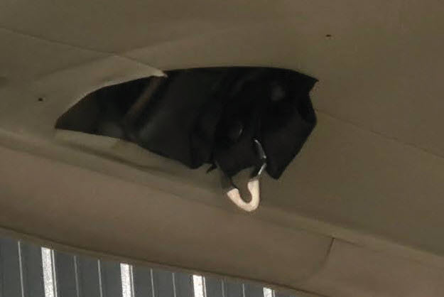

As time passes, the plastic interior parts of our aircraft succumb to the effects of time, sunlight, heat, wear and tear. This usually leads to an unsightly appearance and diminished functionality. Whether it’s a cracked instrument panel cover, discolored, warped window trim or broken covers, should you invest the time and effort in repairs to breathe new life into these parts, or is it more prudent to replace them entirely?
Generally speaking, if the parts have become discolored or chalky in appearance, but are otherwise not cracked or badly warped and you are handy, it may be worthwhile to carefully remove the various parts from the aircraft, clean, and paint them. Keep in mind that any parts that are more than 15-20 years old will likely be very brittle and need to be handled with great care to avoid fracturing them. If they fracture or break, you will need to replace them.
On the flip side, repairs might not provide a satisfying appearance or long-lasting solution, especially if the original parts are just plain tired. Sometimes you need to know when to let go.

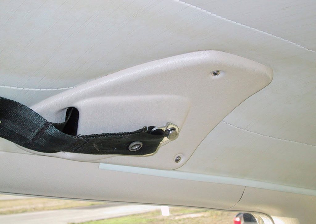

Time to Replace
If you don’t want to invest the time and effort to repair, or feel that it won’t yield a satisfactory result, you can find new interior parts in an online search. Be aware that some ‘new’ parts are not ready for installation and may require considerable effort trimming and cutting openings to get them to fit properly. Verify that the new parts you are buying are properly trimmed with the necessary openings and as ready for installation as possible. Whatever you may save on the purchase price for unfinished parts will quickly be eaten up by the time and effort it will take to install them.
Keep in mind that you own a hand-crafted aircraft and that in subtle ways, no two are alike. Even with fully trimmed and ready to install parts, be prepared to spend some time and effort to carefully install and, if necessary, make small adjustments to the new parts so that they fit your aircraft perfectly. You will savor the final result for years to come.
