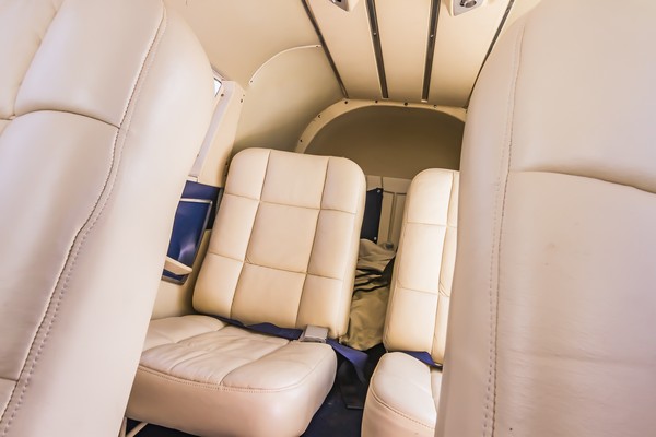

Accordingly, the airplane could be stripped down to cargo configuration in just a few minutes. The test machine I flew was outfitted with all seven seats in place, however, in a 2/3/2 pattern. Admittedly, the center set of seats would be chummy for three across, as the real intent of the seven-seat option was to have kids occupy at least two of them.
