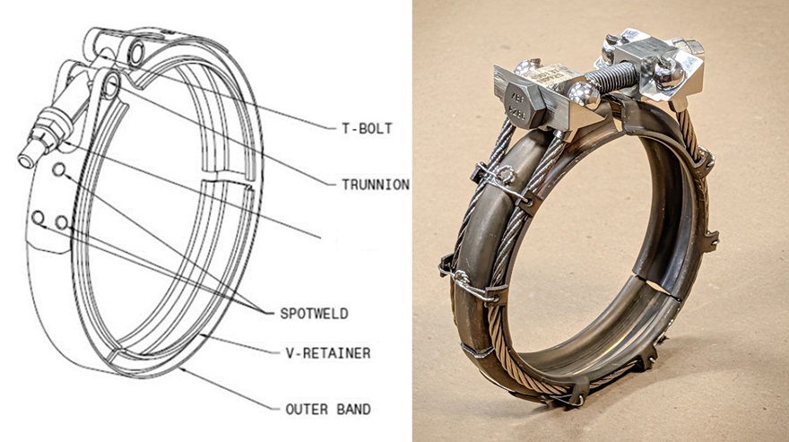

For decades, the connection between a turbocharger and an aircraft’s exhaust system has been a known weak point. The connection is secured by a component called a V-band coupling, which holds the exhaust tailpipe and turbocharger together. Exposure to extreme heat and vibration can cause traditional clamps—especially those built with spot welds or riveted joints—to warp or fail.

The AeroForce V-Band Clamp, approved Feb. 27 under an FAA PMA supplement, features a design that reduces the number of welds and rivets typically found in traditional clamps. Instead, it incorporates a braided wire cable and floating retainer, which are intended to improve durability and simplify installation.
