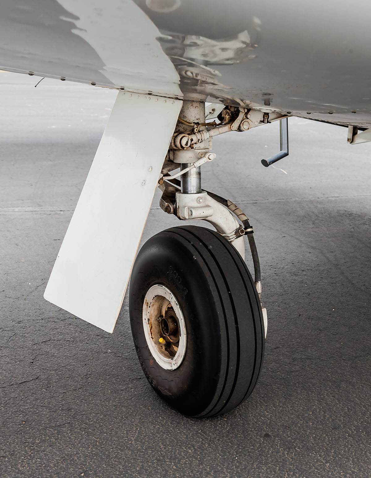

I entered the pattern at BGR, selected gear down and watched as the three gear lights illuminated — one, two …. Oh well, no big deal, I thought, it’s just a little cold and stiff outside. I’ll just recycle. I put the wheels back to bed, waited for a sec­ond and put the switch back down again. One, two ….
I tried the same trick a half-dozen times, and the left main gear stubbornly refused to lock into place. Hmm, not good. I knew the problem had to be related to the frozen sky. Time to try the emergency system, I deduced. I pulled out the manual, followed the checklist item by item and deployed the wheels.
Still no joy on the left main. I flew by the tower, and they verified the left main was only about half deployed. Now, I was pretty much out of options … or was I? Somewhere back in the cobwebs of my brain, I remembered a procedure that a World War II pilot had mentioned when the right main of his fighter had failed to extend.
He’d put the airplane into a hard right knife edge attitude and slammed the top (left) rudder hard against the floor, putting a download on the bottom gear. After several violent stabs of the pedal, he finally had a safe indication and landed without incident.
It didn’t seem to work for me. I tried the same trick a half-dozen times in the opposite direction and couldn’t get a green on the left. In failing light, I flew by the tower one more time, and the controller suggested the left main now looked “pretty much down.” Encouraged, I climbed back up to 2,000 feet east of the airport and stabbed the pedal another four times. Finally — a green light on the left main.
I landed with the fire truck chasing me, taxied into Aerofu­sion, the primary maintenance shop at Bangor in those days, and retired to Captain Nick’s for some Maine lobster.
The following morning, the mechanic reported the gear sim­ply needed a special lubricant designed for cold weather and pronounced it fixed. Sitting in the warm shop, the Mirage folded its wheels up and down several times without a problem.
