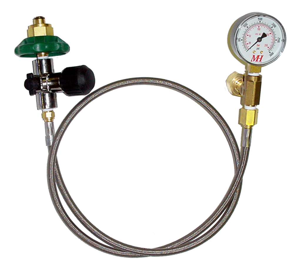

  3. Install a transfill hose — a high-pressure hose with appropriate connectors and gauges. Mountain High provides an as­sortment of high-quality transfill hoses to get the job done. A model TR-95 is an easy-to-use transfill hose which features a gauge on one end as well as a bleed valve to easily release pressure in the line after filling to make disconnecting the hose simple. Find the TR-95 and other hoses at www.mhoxygen.com > Products > Ground Support Equipment > Transfillers.

oxygen transfiller hose

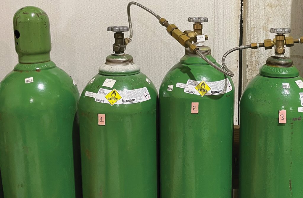

  • Cascading multiple supply tanks: You can reduce the number of supply cylinder exchanges by cascading (i.e. daisy chaining) multiple supply cylinders together. This enables you to preserve high-end pressure in some tanks while utilizing otherwise discarded low-end pressure in others. Learn more in Mountain High’s How to Cascade Oxygen Supply Tanks video.
