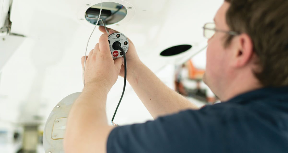

Most STC installation manuals instruct you to use standard calibration, draining the fuel tanks and adding measured fuel in steps while recording the fuel sender output for each, to your tanks. However, reverse calibration, starting with full tanks and draining them in known increments, is a more accurate way to test bladder-style tanks because:
- They are flexible and do not deform uniformly when being filled and emptied
- The resulting calibration curve can appear flat near empty, under-reporting fuel.
- Top-end accuracy is difficult to trust, especially with aging or misshaped bladders.
By starting with a full tank and draining fuel in steps, the tank collapses naturally — and the sender readings more accurately reflect real-world conditions. Among the aircraft that benefit from this method are early single-engine Cessnas with bladder-style mains and Cessna twin-engines with auxiliary tanks.

Reverse Data Capture:
- Fill the tank completely
- Drain in precise steps (e.g., 5-gallon intervals)
- Record fuel quantity removed and sender output at each point
- Use your EFIS or engine monitor to log raw frequency
- Maintain aircraft in level flight attitude
Feed the Data (In Compliance):
- Use a precision frequency signal generator to inject the recorded frequency values back into the instrument
- Perform the standard empty-to-full calibration, matching your signal injection to fuel levels at each step. Your data should match actual tank behavior.
