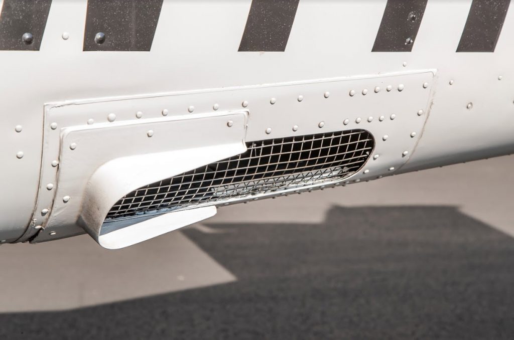

1. Exterior
“It is unbelievable how often wasps or other insects will choose the pita tube to build a nest,” said Phil Sanders of Triple S Repairs. And, that isn’t the only place you should check to see if something has made a home while your craft was down. Static pressure orifices are another great place for critters to dwell and, of course, can present a problem if they do.
“While you’re examining the outside of the plane,” Boyd Maddox, owner of B & D Repairs in Houston, Texas, suggested, “you will want to check the flaps and elevators.”
The goal here is twofold. First, you want to make sure that nothing got bent during downtime. Next, be sure to lubricate the flap hinges and the control surfaces. “I always make sure to verify that the trim tab on the vertical stabilizer isn’t damaged or bent, either,” Sanders added.
All of our experts were quick to point out that an over-all inspection of the skin is in order. Make sure there are no “ruptures” in the skin and that there’s no corrosion that might get out of hand if not attended to.
