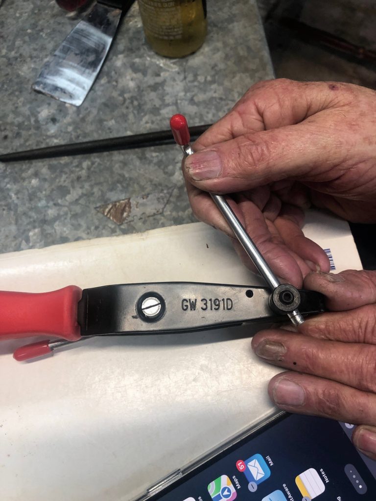

Stainless steel band clamps
Install the band clamp using an installation tool, which is available from several suppliers. Tighten the clamp until sleeve material bulges around the clamp. The tool winds the band around the slotted shaft to tighten the band. The tool then cuts the band and leaves 1″ of band material remaining.
The tool shown is available from Northern Tool P/N GW 3191D, $65. Other versions are available from other suppliers.
Trim the clamp band, leaving 3/8” material. Fold the remaining tab back over the clamp on a hard surface using a soft hammer.
