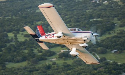

Lance flies purely for pleasure, and the plane he owns, a 1977 Piper Cherokee, fits his mission well. “This is the second airplane I’ve owned. Both of them happen to be Piper Cherokee 140s. I’m a really big fan of the PA-28.
“My first airplane was a 1969 Cherokee 140 that I purchased in the 2003-ish time frame, so it was quite a while ago. I really enjoyed the plane, but it gets expensive when you have young kids like I did at the time. I only kept it for about three years, then I sold it. And then I bought this one about four years ago. I’m still a big fan of the Cherokee. I love them to death.”
At more than four decades old, his 140 is definitely a legacy Piper, but as Lance pointed out, “It’s the newest Cherokee 140 you could get back in ’77, the last year they actually made that particular model before they went up to the Warriors.”

An Excellent Buy
Lance considers himself fortunate to have found his current plane locally and in such good condition. “It was purchased from my home airport,” he said. “I was a member of the local flying club at the Rusty Allen Airport outside of Austin, Texas. And this one gentleman who was elderly, lost his medical and was looking to sell it. He didn’t really want to because you know he loved his airplane, but he didn’t really fly it for like a year. So I was able to pick it up from him.
“I had some mechanic friends take a look at it. I think I had to replace a cylinder because it sat for a year. But other than that, the plane has been just beautiful to fly. And no real mechanical problems, just normal maintenance.”
