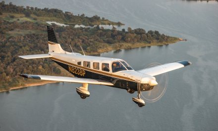

Though now out of production, the Piper Warrior was a capable competitor to Cessna’s Skyhawk.
Park a Warrior next to a Skyhawk, and the primary differences would be all too apparent. Most obviously, the Warrior mounts its wing below the fuselage, whereas the Skyhawk flies beneath a high wing. The Cessna allows admission through two doors, while the Warrior makes do with one on the copilot’s side.

Born of the Cherokee 140 in 1977, the original Warrior sported 150 hp and a stepped, semi-tapered airfoil design that looked sexier than the original, Piper Hershey-bar wing, but didn’t really deliver much aerodynamic benefit. Piper claimed slightly improved roll response and better performance, but most pilots couldn’t tell the difference. Perhaps it was enough that the Warrior simply looked better. By 1977, Piper decided to upgrade to the 160 hp engine, and that was the last substantive airframe change until the close of production in 2012.
These days, you can buy one of the early Warriors for as little as $25,000. The 1977-up variety are available for prices starting at $30,000 and ranging up into the $200,000 bracket—if you feel a need for a glass panel and all the goodies that come with Piper’s more modern iteration of trainer.
With their spiffy wheel pants, tapered low wing, and swept appearance, the Warrior design did upgrade the look of the standard PA-28-150, but Cessna had a major lead that Piper was never able to close.
